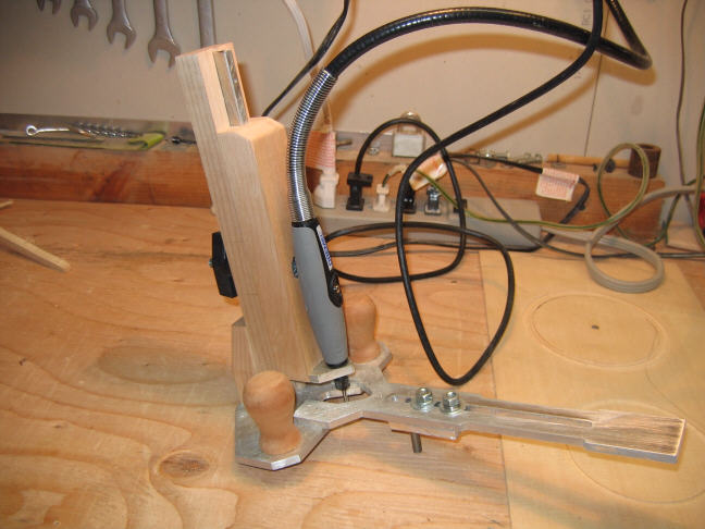

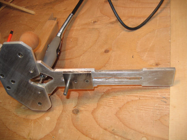

Wow Bruce!! As I say to my wife everytime I finish off one of these little jigs, etc. "Vinney better look out cause the Tuttles (Sp) may be getting a new fabricator! (American Chopper)." Then my wife always informs me that Vinney is in no danger from me!! She knows how to hurt a guy! But here is the kind of things you can do with common woodworking tools, table saw, chopsaw, router table, drill press, bandsaw, oh ya and a tap and die set:
By day I am a mild mannered safety guy so I have a couple of things to say about working with aluminum. First a word on grinding it....DON'T!!! Aluminum is a non-ferrous metal and most grinding wheels are not designed to grind these metals. The aluminum will clog the wheel causing it to over heat with high potential for the stone flying apart at 5,000 rpm. We have a couple of serious injuries a year from this in British Columbia and every once in while someone gets hit in the wrong spot and dies. Use your belt sander, you will get much better results, much faster and much safer. All of your carbide tools will cut aluminum, just take it slow and hold things tight. It makes a horrible racket when you are used to cutting wood but everything will turn out great. When routing slots, like on the dremel jig above, just do a series of small passes and use stop blocks on your router table. Making these jigs is a lot of fun and you can actually make very high accuracy tools with a bit of imagination and all of the tools you probably already have! Thanks Bruce for keeping everyone going on these things.

A problem with the circle cutters is micro adjustment. I want to make one with a built in dial caliper, so micro adjustments will be a snap to get perfect cuts.
Your tool above should be put into Jigs and Tools section of the OLF so others can see the idea of shaping aluminum with a bandsaw.
Evidently you use tablesaw and router too on aluminum? Is that right?

I thought of a dial guage, I saw that someone did that, maybe in tools and jigs section. But I found that I can index off the square edge at the front of the router base and the sliding thingy (getting technical now, hold on!). So once I have my first dimension set I can measue with my digital calipers, then zero them on that measurement and add the bit that I have left to do. I have only used it once so far but found that I could get within .002" without any mucking around. Close enough for the girls that will dance with me.
As for other tools, yup, any carbide cutter will standup to aluminum (the machinests around this forum will porbably tell us that any tool steel will, but I only have experience with carbide). I actually have a table saw blade designed to cut non-ferrous metals. But on occasion, when I have one of my not so nice saw blades on the saw and only have one or two aluminum cuts to make I just use a regular combination blade on the table saw.
